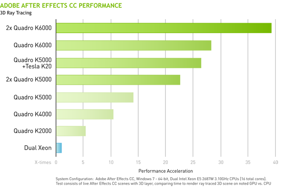

Ako išta radi u 3D u adobe programima - nvidiu
Sa službene adobe stranice
After Effects CS6 and later includes a ray-traced 3D environment, within which you can bend 2D layers, extrude text and shapes, and more.
The ray-traced 3D renderer can run on the CPU, but the CPU-based ray-traced 3D renderer is rather slow in Final Quality mode. That’s why After Effects also has a GPU-accelerated 3D renderer. To use the GPU-accelerated ray-traced 3D renderer, you must have one of a specific set of Nvidia graphics cards. The GPU acceleration of the ray-traced 3D renderer depends on the OptiX library from Nvidia, which requires CUDA on an Nvidia GPU.

Znači R9 je jača - ali samo u gamingu, ali AKO mu treba za after effects 3D razlika u korist nvidije je ogromna, jer ati u tom slučaju uopće ne podržava gpu akceleraciju (kao što piše gore).
Evo da vidiš razliku između raznih nvidia:
