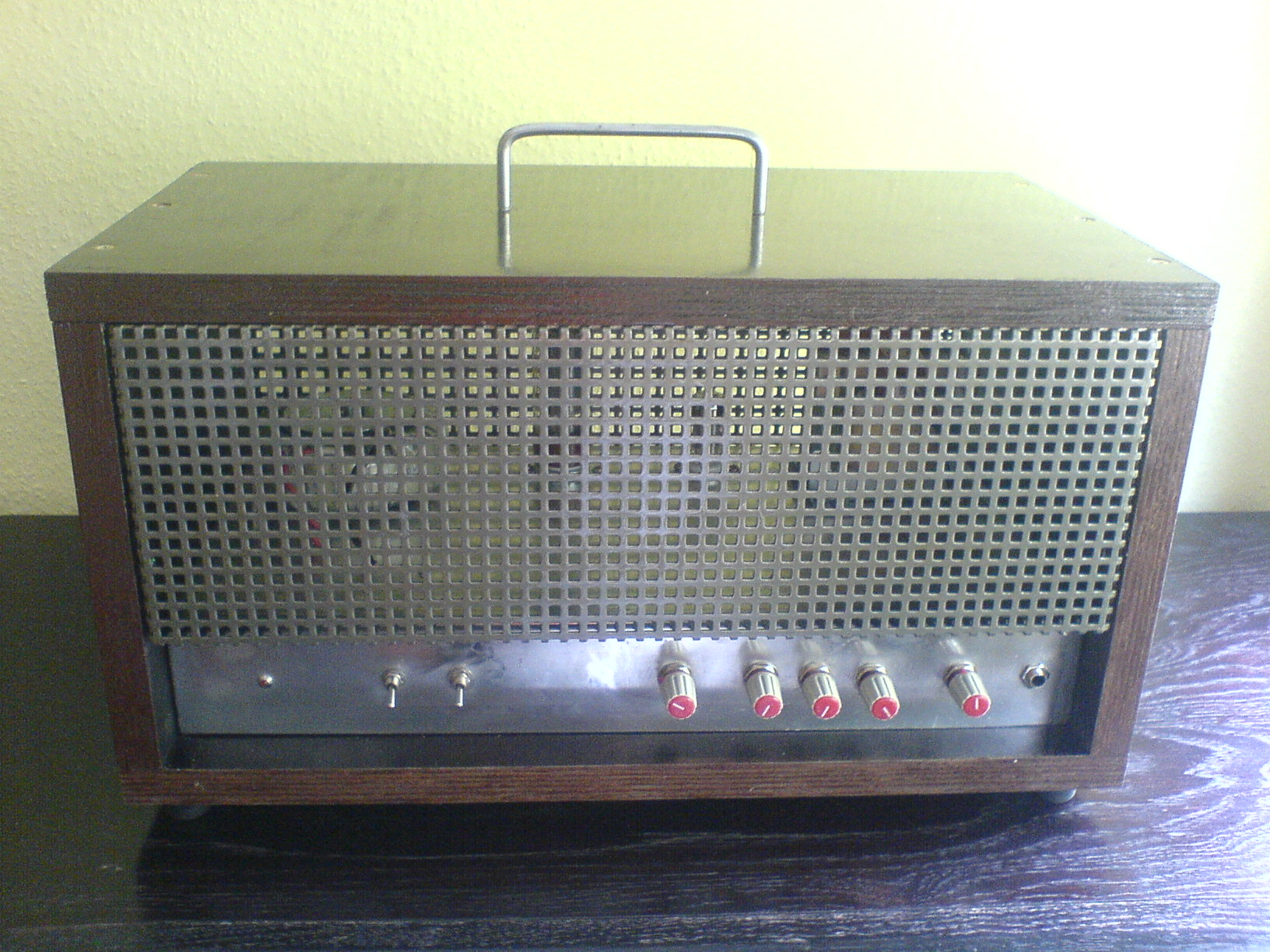

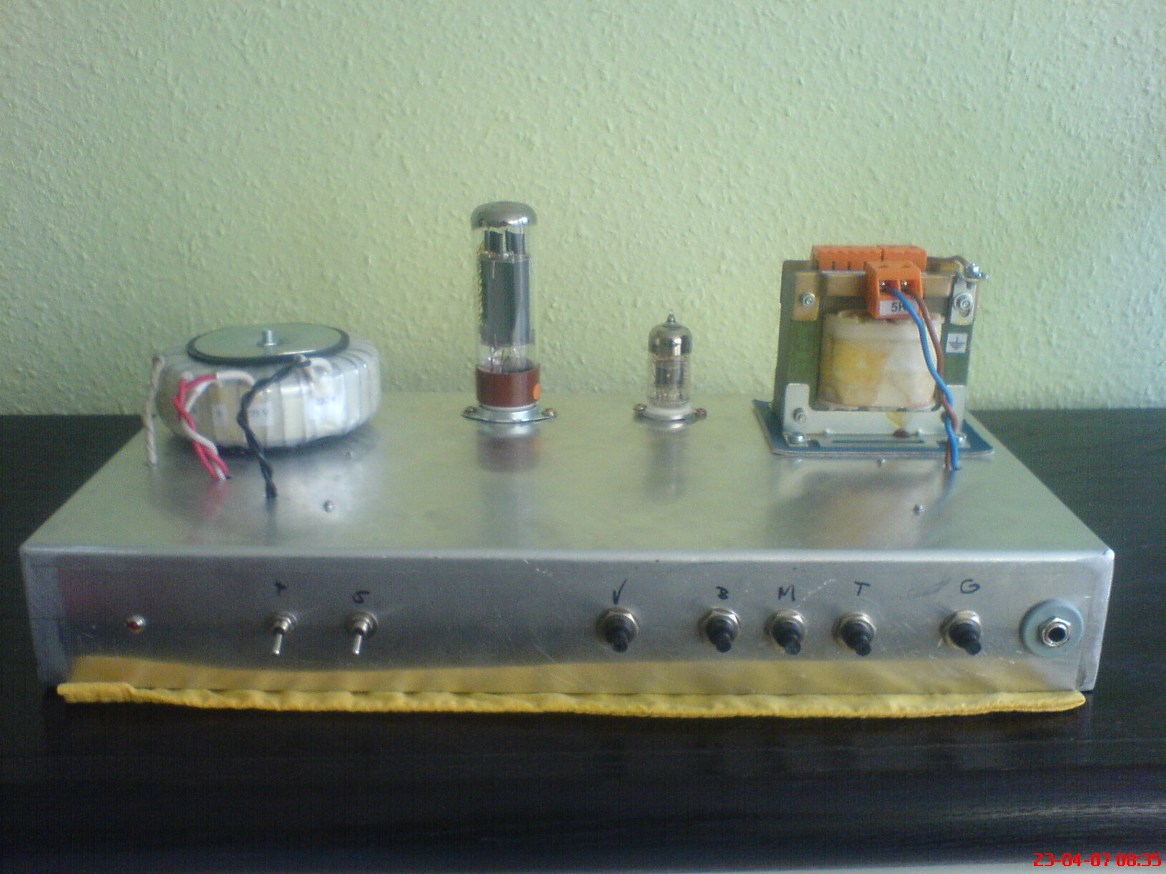

ID:	22945   Click image for larger version
