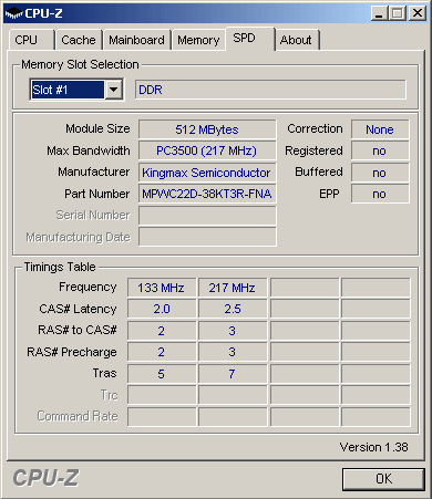

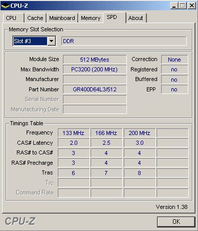

Sto se tice screenshotova, evo ih, po jedan za svaki par identicnih plocica:
ID:	6882   Click image for larger version
