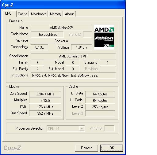

T-bred XP1700+ JIUCB 0251, na KX7-333R, 1,85V, cooler tt7+:
jaksa je offline   Reply With Quote
