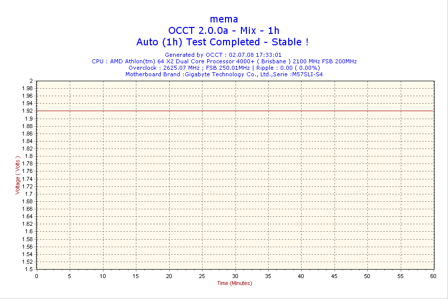

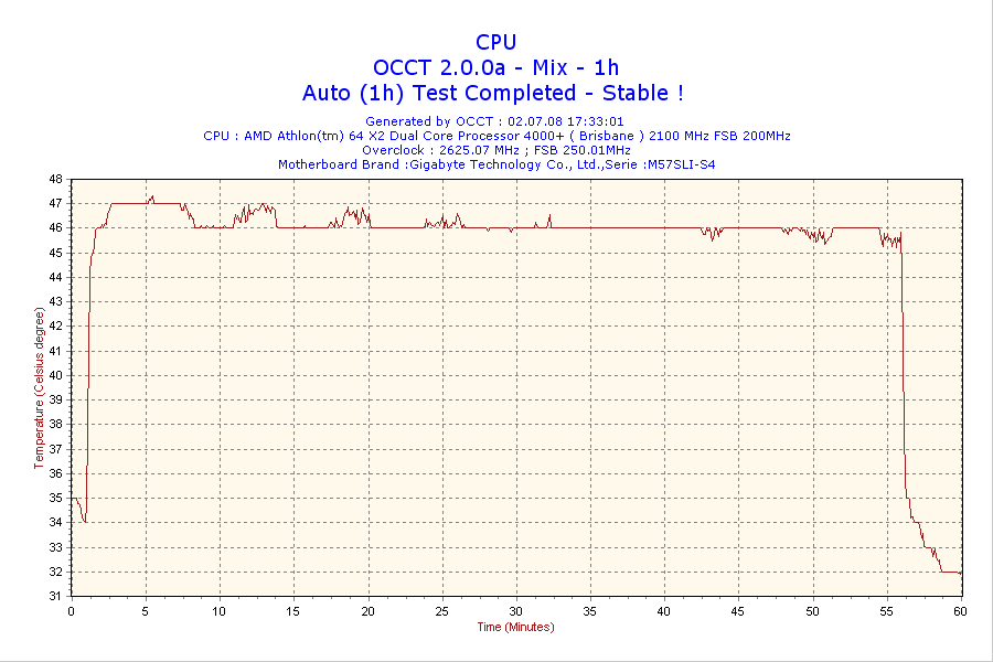

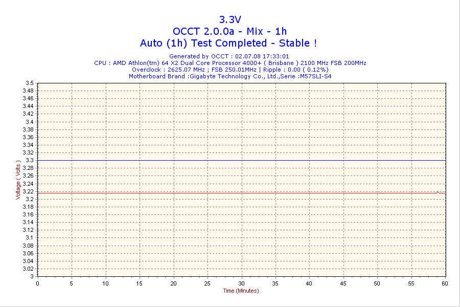

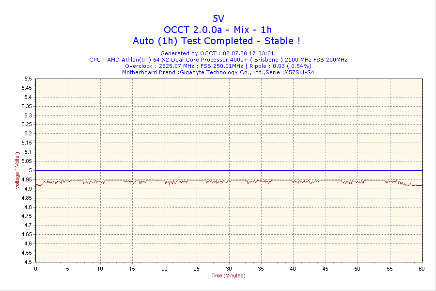

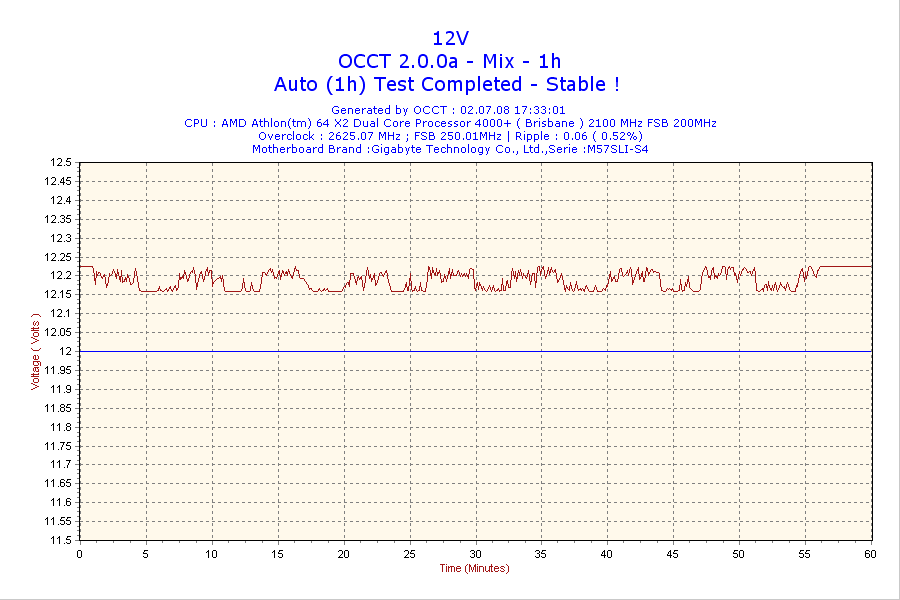

OCCT v2.0.0a
u attach su slike.
Freezer 64 Pro na procesoru.
Zasto ovako napon skoci ja neznam.
ID:	8674   Click image for larger version
ID:	8675   Click image for larger version
ID:	8676   Click image for larger version
ID:	8677   Click image for larger version
ID:	8679   Click image for larger version
ID:	8680   Click image for larger version
