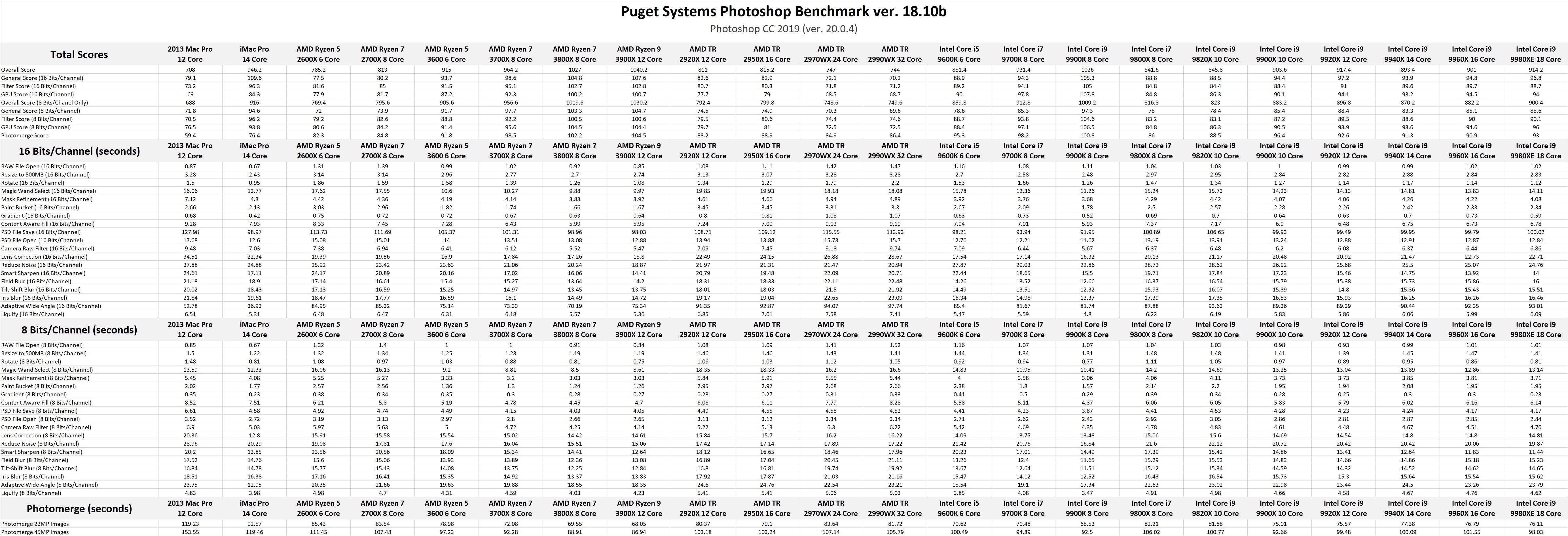

Kao što Brko kaže , ako gejmaš odi na 3600, ako rendaš onda 2700.
Pogledaj testove i odlući što ti je bitnije
Što se tiće razlike u igrama 3600 vs 2700X i render ( Cinebench R20, Blender, Premiere PRO CC 2019, V-Ray, Corona 1.3 ) provjeri tu https://www.techspot.com/review/1871-amd-ryzen-3600/
testove za Premiere pogledaj tu https://www.pugetsystems.com/labs/ar...nchmarkResults
EDIT:
Photoshop: https://www.pugetsystems.com/pic_disp.php?id=56164
