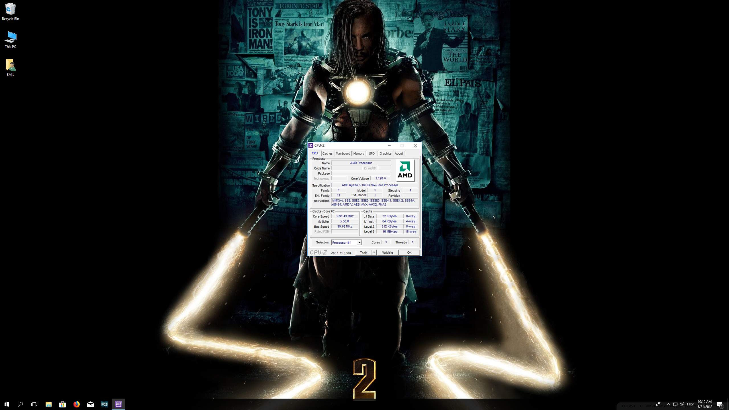

Postovi: 1,805
Asus Crosshair VII Hero - AMD Ryzen 7 2700x - G.Skill F4-3200C14-8GTZRX (2x8Gb) https://valid.x86.fr/stccwi Kasnije oc... |
