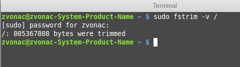

Izgleda da je po defaultu trim na samsungovom ssdu upaljen.. https://sites.google.com/site/lightr...bledandworking Okinul sam ovu skriptu, ali... Trebal bi dobit ovo: If TRIM is properly working the result of the last command should be a bunch of zeros.. Al u mom slučaju ko da nekaj ne štima, prva slika... Dok pokrenem u terminalu, sudo fstrim -v / /: 1129930752 bytes were trimmed Poovom bi ispalo da radi...hmmm EDIT: Pokrenul sam i ovo: Become root: sudo -i Make a 50MB file with random data: dd if=/dev/urandom of=tempfile count=100 bs=512k oflag=direct Check the starting LBA address of the file: hdparm --fibmap tempfile Read the first address of the file, note that you need to put the first LBA in place of [ADDRESS]: hdparm --read-sector [ADDRESS] /dev/sdX Now remove the file and synchronize the filesystem: rm tempfile sync Use the same command as in 4 to re-read the LBA: hdparm --read-sector [ADDRESS] /dev/sdX Al i tu nekaj ne štima, druga slika.. Zadnje izmijenjeno od: zvonac. 04.07.2014. u 19:56. |

Nego našel sam nekaj drugo... Ovo sam koristil... Preferred method: by rc.local 8.1. You can add the TRIM command to /etc/rc.local. Then this command will be executed automatically on system boot. This hardly slows the boot process down. This is the method that I prefer. You can do that as follows: a. First make sure that you have installed the applications gksu and leafpad. b. Then type in the terminal (use copy/paste): gksudo leafpad /etc/rc.local Press Enter. c. Above the line exit 0 in that file, you now add the TRIM command fstrim -v for every automatically mounted EXT4 partition. Note: not for partitions that aren't mounted by default! And also not for the swap partition, as that's already being trimmed automatically by the system by default, during the boot process. An example is most clarifying. When your Ubuntu is on one single partition, so you have only the root partition / , then your rc.local should look like this: #!/bin/sh -e # # rc.local # # This script is executed at the end of each multiuser runlevel. # Make sure that the script will "exit 0" on success or any other # value on error. # # In order to enable or disable this script just change the execution # bits. # # By default this script does nothing. fstrim -v / exit 0 A ovo isto koristim, ručno.. How to execute TRIM manually 9. You can execute TRIM manually as well, namely as follows: Click on the grey Ubuntu logo (Dash home). Query: terminal. Click on Terminal. Type (use copy/paste): sudo fstrim -v / Press Enter. Type your password when prompted; this remains entirely invisible, not even dots will show, this is normal. Press Enter again. This operation may last for minutes; it then looks as if the terminal has frozen. That's not true, however; simply wait patiently.... The above terminal command is enough when you have only one Ubuntu partition and a swap partition (because for the swap it's unnecessary; the system takes care of that automatically). https://sites.google.com/site/easylinuxtipsproject/ssd Izgleda da ima više načina za pokretanje TRIMa tj opcija... Podesil sam da se kod bootanja TRIMa i ručno da ga pokrenem naredbom sudo fstrim -v /.. |
