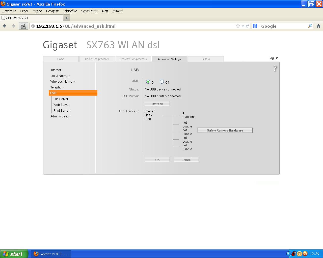

evo kako izgleda kad je USB stick spojen:

Jan 4 18:41:54 Err scm: 073-00-00 CM_USB_MOUNT: -> MOUNTING: >mount /dev/scsi/host0/bus0/target0/lun0/part1 /mnt/usbmsd/share/usb_0 vfat<
Jan 4 18:41:54 War kernel: FAT: bogus logical sector size 6012
Jan 4 18:41:54 War kernel: VFS: Can't find a valid FAT filesystem on dev 08:01.
Jan 4 18:41:54 Err scm: 073-00-00 CM_USB_MOUNT: -> MOUNT-Error VFAT = -1
Jan 4 18:41:54 Err scm: 073-00-00 CM_USB_MOUNT: -> MOUNTING: >mount /dev/scsi/host0/bus0/target0/lun0/part2 /mnt/usbmsd/share/usb_0 vfat<
Jan 4 18:41:54 War kernel: VFS: Can't find a valid FAT filesystem on dev 08:02.
Jan 4 18:41:54 Err scm: 073-00-00 CM_USB_MOUNT: -> MOUNTING: >mount /dev/scsi/host0/bus0/target0/lun0/part3 /mnt/usbmsd/share/usb_0 vfat<
Jan 4 18:41:54 War kernel: VFS: Can't find a valid FAT filesystem on dev 08:03.
Jan 4 18:41:54 Err scm: 073-00-00 CM_USB_MOUNT: -> MOUNTING: >mount /dev/scsi/host0/bus0/target0/lun0/part4 /mnt/usbmsd/share/usb_0 vfat<
Jan 4 18:41:54 War kernel: VFS: Can't find a valid FAT filesystem on dev 08:04.

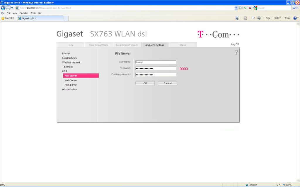

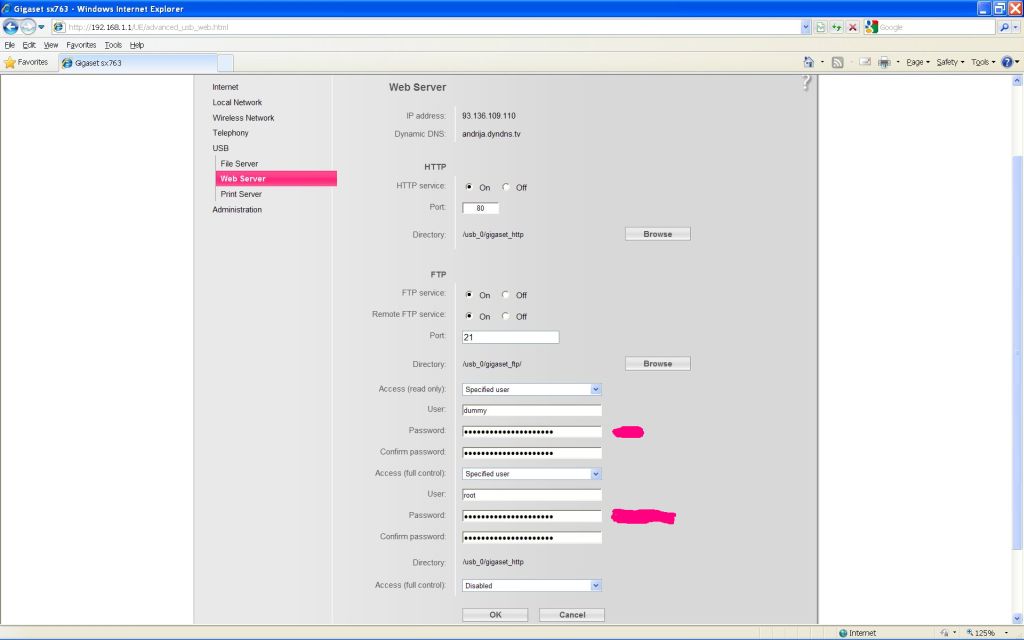

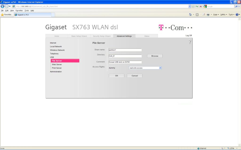

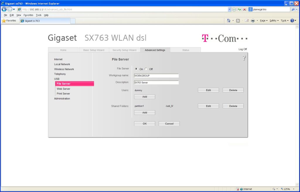

Evo ovako to izgleda kod mene, Corsair Voyager stick formatiran kao FAT32

Andrija M je offline   Reply With Quote
