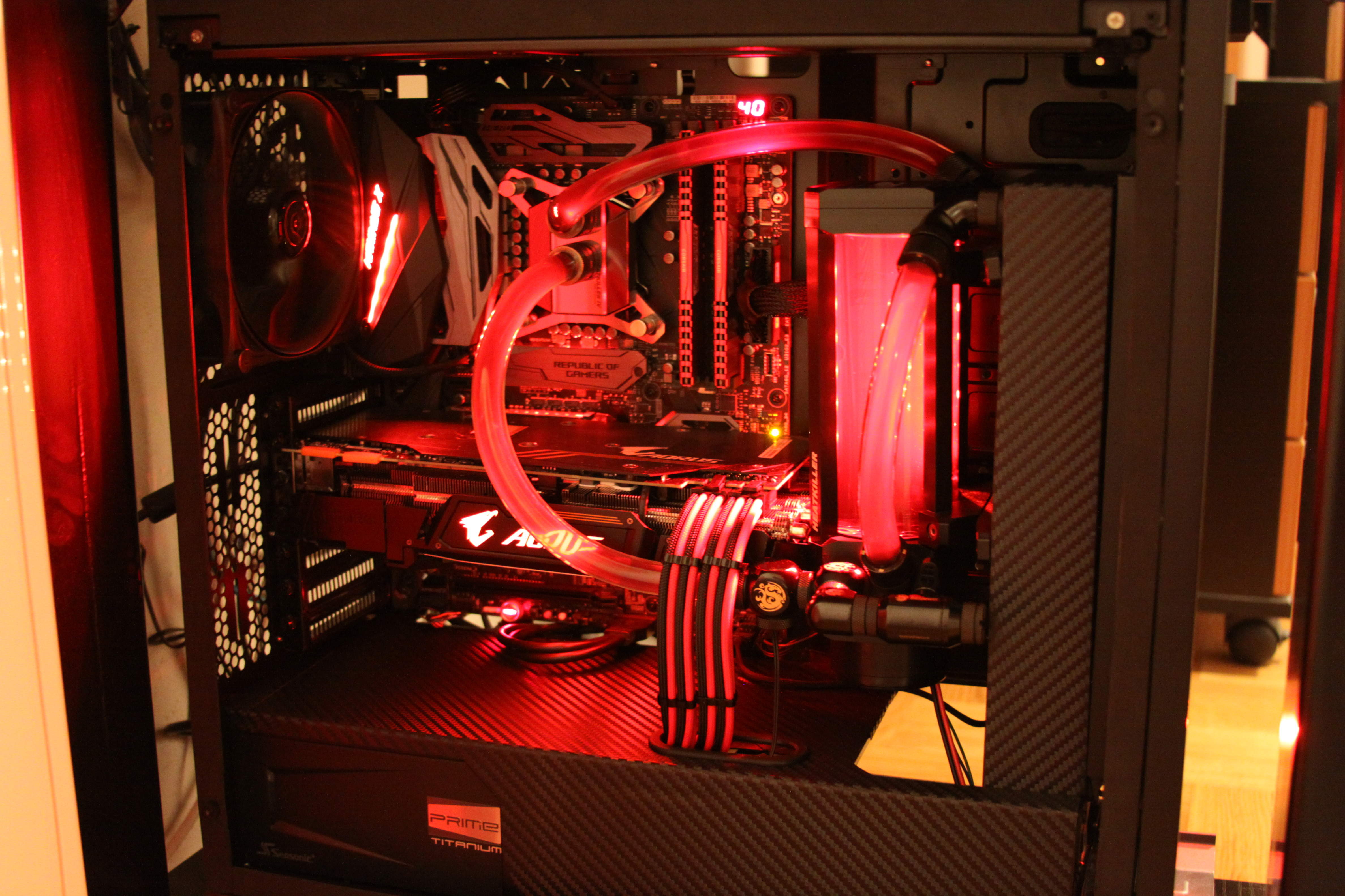

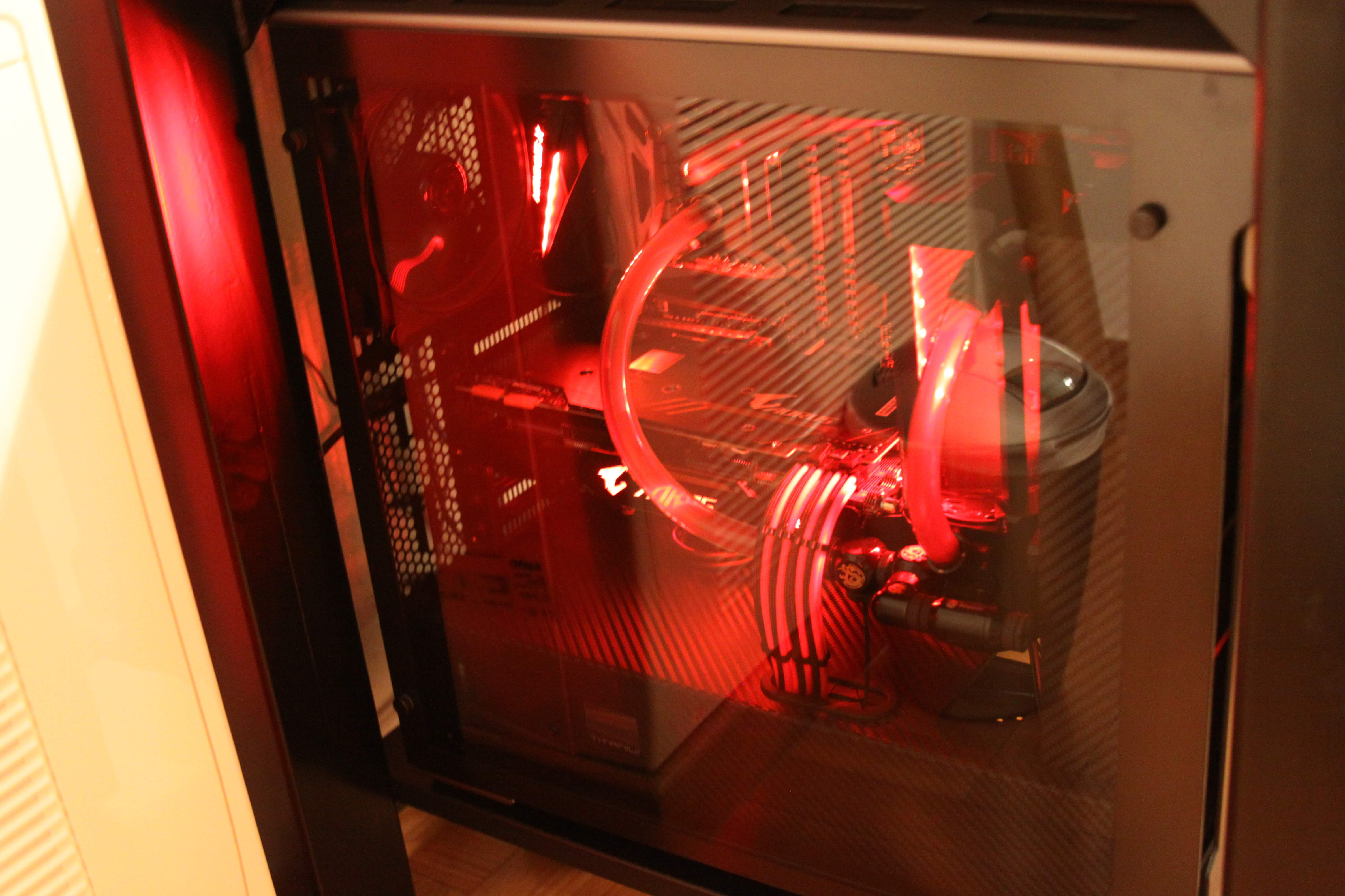

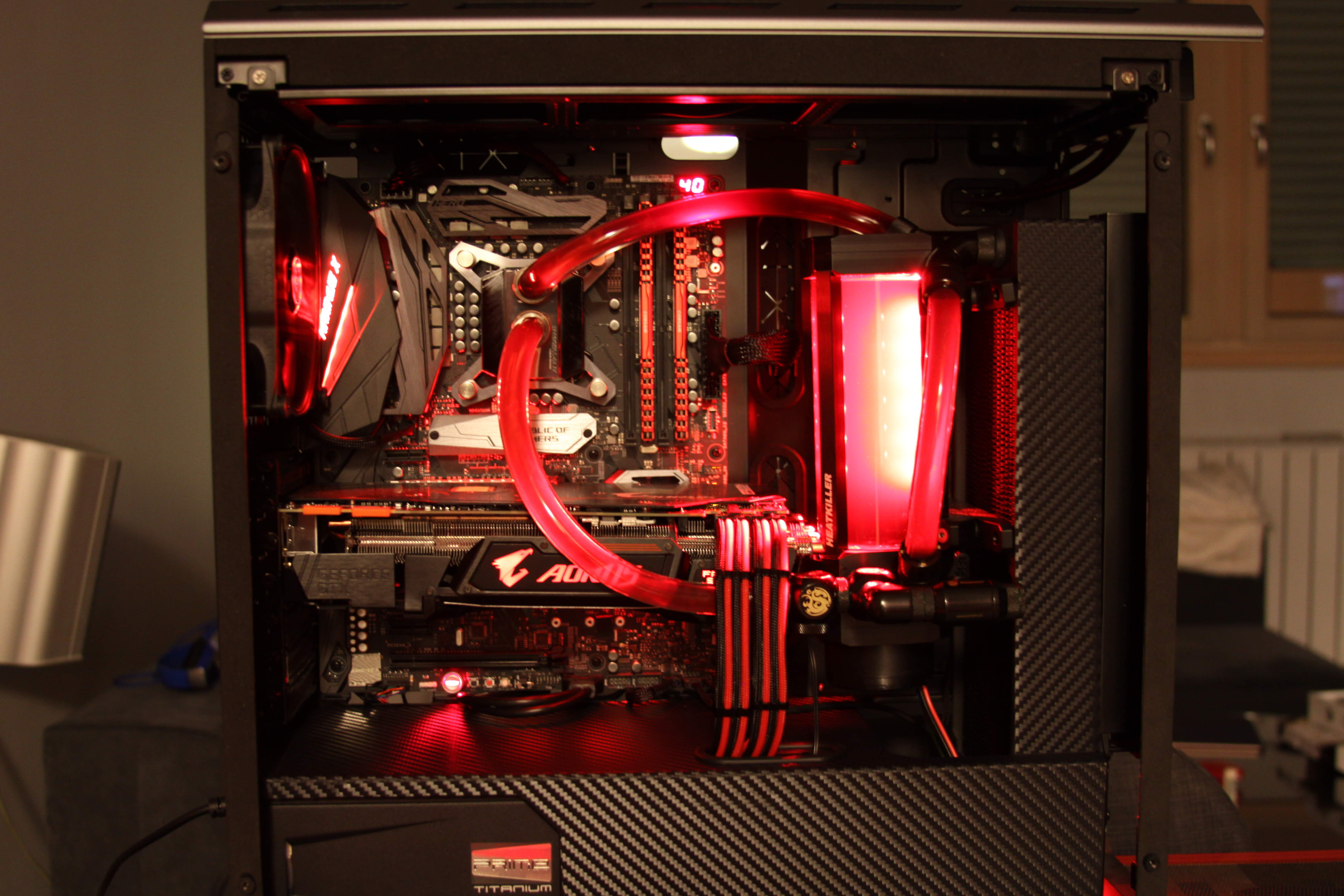

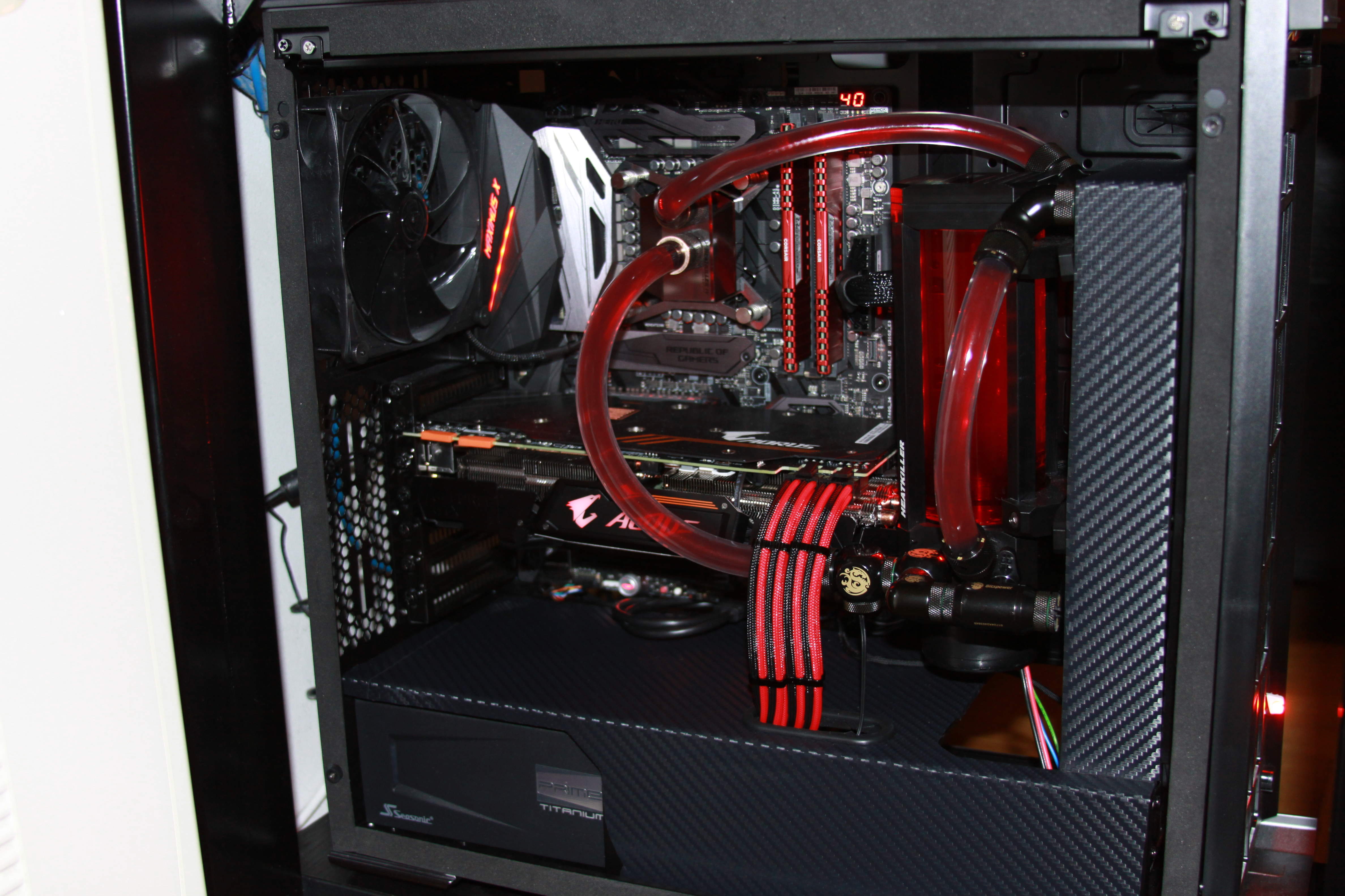

So finally got around to completely finish my first watercooled build.

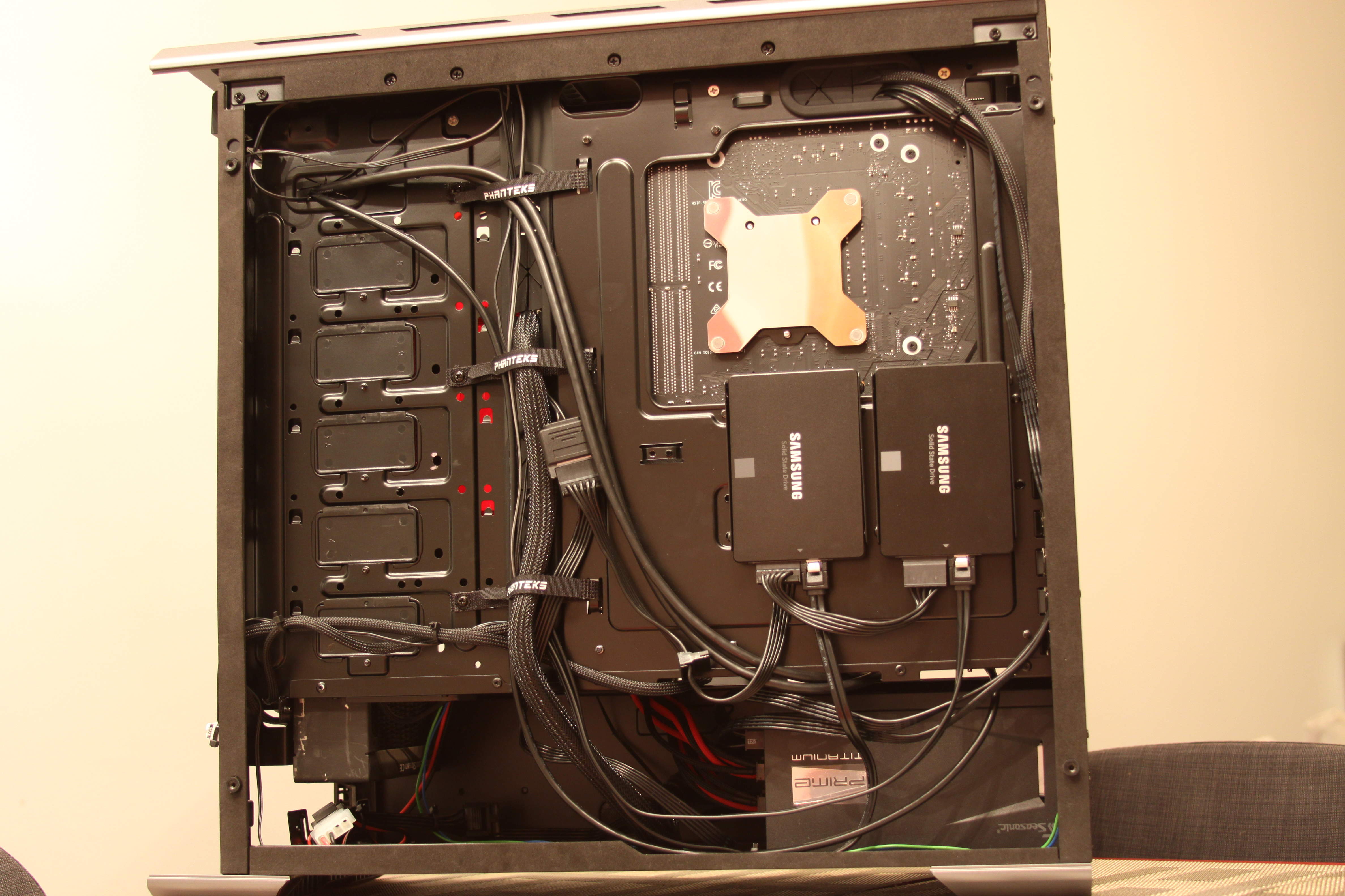

It was a lengthy and painstaking process (had to disassemble everything twice to fix tiny leaks).
The only thing I regret is that I scratched some things up (fittings, res), but Sharpie covers the mistakes well!

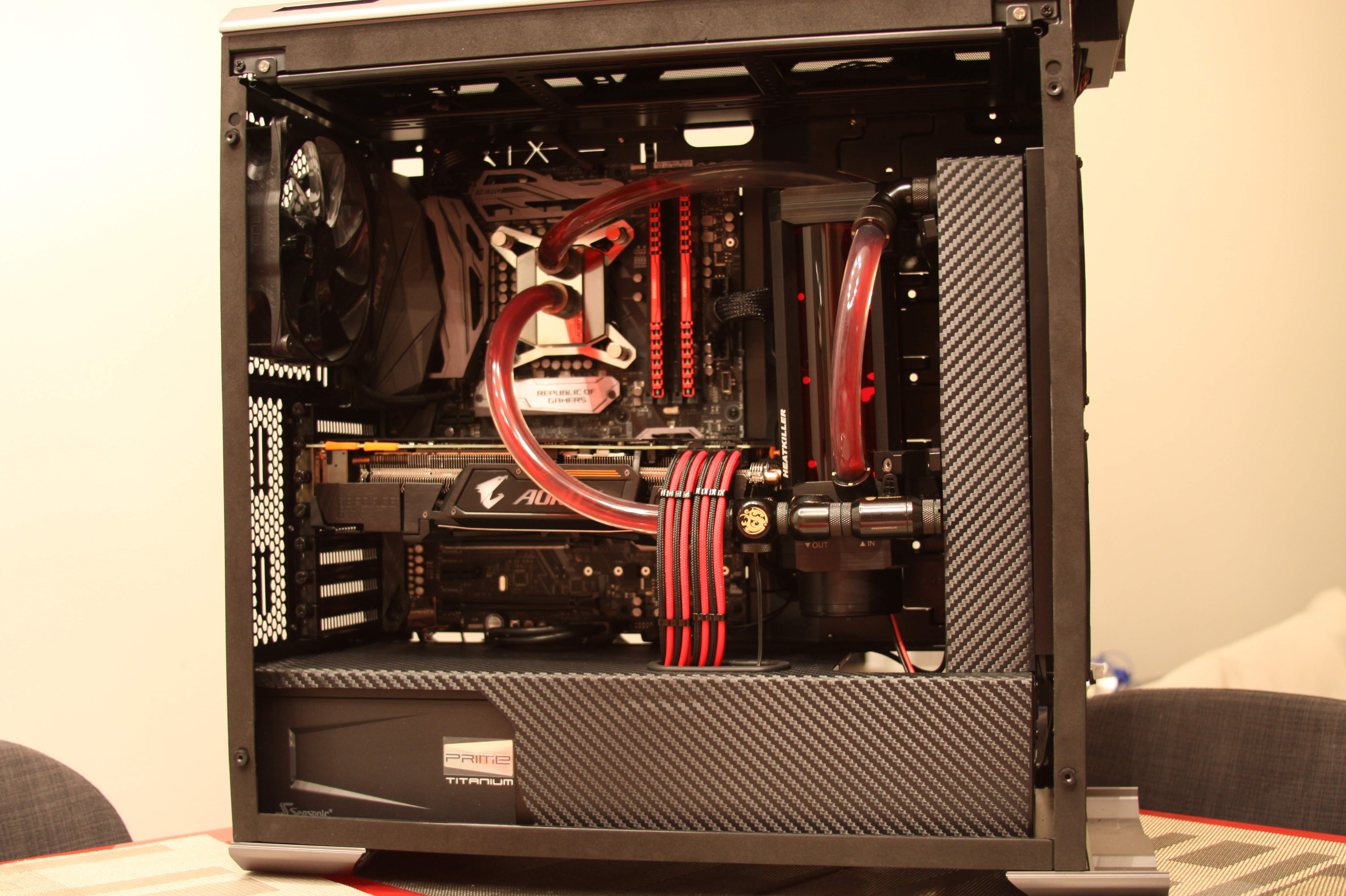

Also it was a very tough fit for the 1080ti, unfortunately didn't think about the spacing and by the time I was building everything the time to be able to exchange the card was passed.
But with some roughage I was able to do it!
Heatkiller Tube is all scratched up on that side, but you can't see them from the card anyway, so in the end not too big of a problem.
Water out temps are 27-28C and CPU cores are usually between 28C and 29C idle (24C room temperature).
Also did the mod where the front of the case is 4mm pushed outwards (didn't change the temps at idle at all, didn't test on full load yet).
Overall I love the build, it's pretty much impossible to hear anything, the most silent PC I have ever (or not) heard!!!

Yes I know that a piece of carbon foil is messed up on the bottom, but you can't see it when the case is closed, and I wasn't going to re-do all of it!

Ok je za prvi puta.
Ali samo napomena. Ravne cijevi + kutnici daju dodatnu dimenziju samom dizajnu, nego ovako savinute cijevi. Za drugi puta

jel bucna ta D5 pumpa, zuji li, na kolko rpm su ti ventovi u idleu i loadu ?

Acryl nije dolazio u obzir za prvi susret sa W/C-om, tu bas trebas znati kaj radis, pogotovo zglobovi sa heatgunom itd.
I naravno slazem se da puno lepse zgleda i sve.
To mozda jednog dana kada cu imat volje i vremena.
@nick praskaton
ovo je idle, cek da izmjerim load na brzaka
u idlu ne znam ni da comp radi
Cooling Fans
CPU 1571 RPM
Chassis #1 674 RPM
Chassis #2 573 RPM
Chassis #3 599 RPM
GPU 0 RPM (0%)
Zadnje izmijenjeno od: brab. 08.02.2018. u 23:49.

Evo i rezultata Prime95 (Small FFTs) testa:
Cooling Fans
CPU 3117 RPM
Chassis #1 1041 RPM
Chassis #2 861 RPM
Chassis #3 903 RPM
GPU 0 RPM (0%)
CPU 59 °C (138 °F)
CPU Package 70 °C (158 °F)
CPU IA Cores 70 °C (158 °F)
CPU GT Cores 41 °C (106 °F)
CPU #1 / Core #1 70 °C (158 °F)
CPU #1 / Core #2 66 °C (151 °F)
CPU #1 / Core #3 70 °C (158 °F)
CPU #1 / Core #4 68 °C (154 °F)
CPU #1 / Core #5 66 °C (151 °F)
CPU #1 / Core #6 67 °C (153 °F)
Pumpa si ni ne cuje ni na maxu, samo ventovi.

koji prime (verzije su bitne). koja frekv, i koji napon
Prime95, v29.4 build 7
A za ostalo kak pise gore :
"i7-8700k (stock speeds currently)"

Ako ti napon nije fiksan, koliko shvaćam da nije. Onda ti regulator u ovisnosti o namještenim postavkama i VID tablicama koje su različite za svaki procesor daje različite napone,+LLC utječe na rezultate temperatura.
Tako da ti temperatura nije usporediva.
Imam slični kompjuter kao ti, i i7 8700k. Trenutno hlađen s NHD14 i razmišljao sam o custom loopu (baš taj hladnjak i pumpa, ek blok) jer su mi temperature visoke (nije delidan procesor). Pa me zato zanima dal bi profitirao s custom loopom.
Ono što mogu reć, je da je meni na auto naponu napon debelo previsok nego što mom procesoru treba da bude stabilan.
I to na svim frekvencijama, i underclock i oc.
Detaljno sam istražavao 3 frekvencije
4.0 s max llc dovoljan je 1,0V
4,8 dovoljan je 1,2V
5,0 dovoljan je 1,3V i temperature su mi previsoke u prime AVX (bez ofseta).
