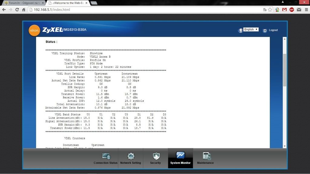

Staro 31.08.2016., 10:00   #3741
MasterX
do you speak it?
Datum registracije: Mar 2003
Lokacija: ::1
Postovi: 1,629
ako imas mogucnosti (lemilica itd.) zalemi spojeve kabela, tako da ti vremenom ne oksidiraju i stvore dodatno gusenje, tj. degradiraju signal i uslugu
evo jednog sretnog lemljenja propusnost se povecala 10 Mbit u DL, za UL nisam zabiljezio vrijednosti, kao ni gusenje (Total Attenuation)
Code:
    VDSL Training Status:   Showtime
                    Mode:   VDSL2 Annex B
            VDSL Profile:   Profile 8b
            Traffic Type:   PTM Mode
             Link Uptime:   0 day: 20 hours: 14 minutes
       VDSL Port Details       Upstream         Downstream
               Line Rate:      5.119 Mbps       20.479 Mbps
    Actual Net Data Rate:      5.120 Mbps       20.480 Mbps
          Trellis Coding:         ON                ON
              SNR Margin:       23.4 dB           19.1 dB
            Actual Delay:          0 ms              0 ms
          Transmit Power:      -11.9 dBm           4.5 dBm
           Receive Power:        0.0 dBm           2.3 dBm
              Actual INP:       12.0 symbols      27.0 symbols
       Total Attenuation:        0.2 dB            3.4 dB
Attainable Net Data Rate:     17.917 Mbps       70.472 Mbps
      VDSL Band Status    U0      U1      U2      U3      D1      D2      D3
  Line Attenuation(dB):  4.7     9.8     N/A     N/A     6.9    13.1     N/A
Signal Attenuation(dB):  4.7     9.6     N/A     N/A     5.5    13.0     N/A
        SNR Margin(dB): 23.7    23.4     N/A     N/A    19.1    19.1     N/A
   Transmit Power(dBm):-21.4   -12.3     N/A     N/A     3.9   - 4.6     N/A

Stanje parice prije godinu i pol kad sam prešao na Iskon:
http://i36.photobucket.com/albums/e3...psbeske7og.jpg
I sadašnje stanje:
Code:
                    Mode:   VDSL2 Annex B
             Link Uptime:   24 days: 1 hour: 12 minutes
               Line Rate:      1.823 Mbps       20.479 Mbps
    Actual Net Data Rate:      1.824 Mbps       20.480 Mbps
              SNR Margin:        5.5 dB            8.4 dB
          Transmit Power:       12.7 dBm          18.5 dBm
           Receive Power:        1.3 dBm           0.5 dBm
              Actual INP:       13.0 symbols      27.0 symbols
       Total Attenuation:       11.5 dB           18.0 dB
Attainable Net Data Rate:      1.986 Mbps       24.191 Mbps
  Line Attenuation(dB): 16.9     N/A     N/A     N/A    29.5    84.9     N/A
Signal Attenuation(dB): 16.9     N/A     N/A     N/A    26.9     N/A     N/A
        SNR Margin(dB):  5.5     N/A     N/A     N/A     8.4     N/A     N/A
   Transmit Power(dBm): 12.7     N/A     N/A     N/A    18.6     N/A     N/A
