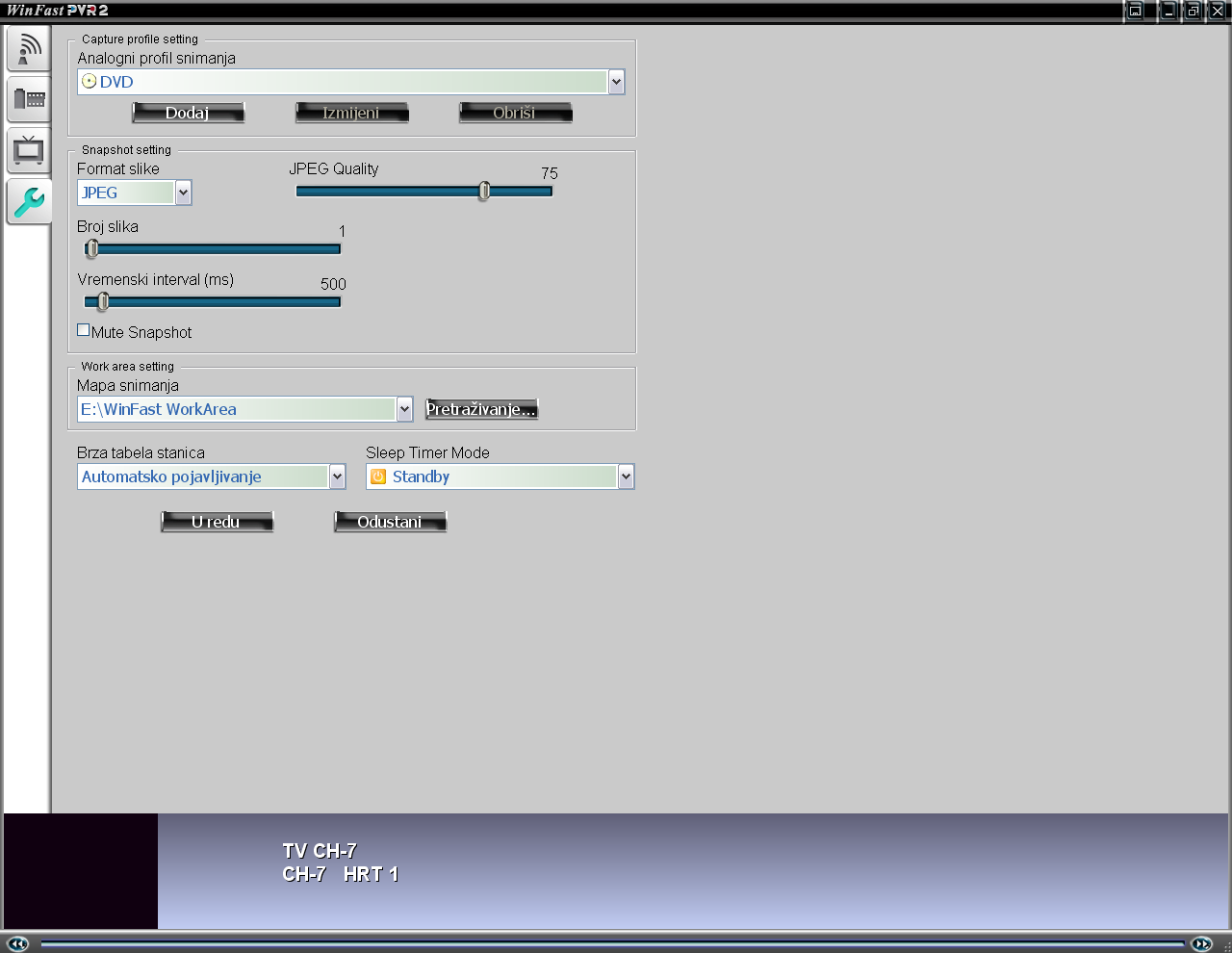

dobošar
dobošar's Avatar
Postovi: 58
Evo spajanja, postavki i slika za Bernstein audio modul i Leadtek TV kartice. Još neka mi netko objasni kako da ubacim slike.

Staro 23.02.2009., 00:00   #41
dobošar
dobošar's Avatar
Postovi: 58
Cool
Uspjeh!!!
Name:	Bernstein audio modul.png
ID:	9361 Click image for larger version
Name:	Contol p. Playback.png
ID:	9362 Click image for larger version
ID:	9363 Click image for larger version
ID:	9364 Click image for larger version
ID:	9365 Click image for larger version

Postovi: 3,593
Jesi li dobro okrenuo audio kabl u tv kartici i audio modulu? Zna se desiti da nemaju onu kukicu pa ih mozes i naopako okrenuti. Imas li fotoaparat da slikas v karticu i uadio modul?
