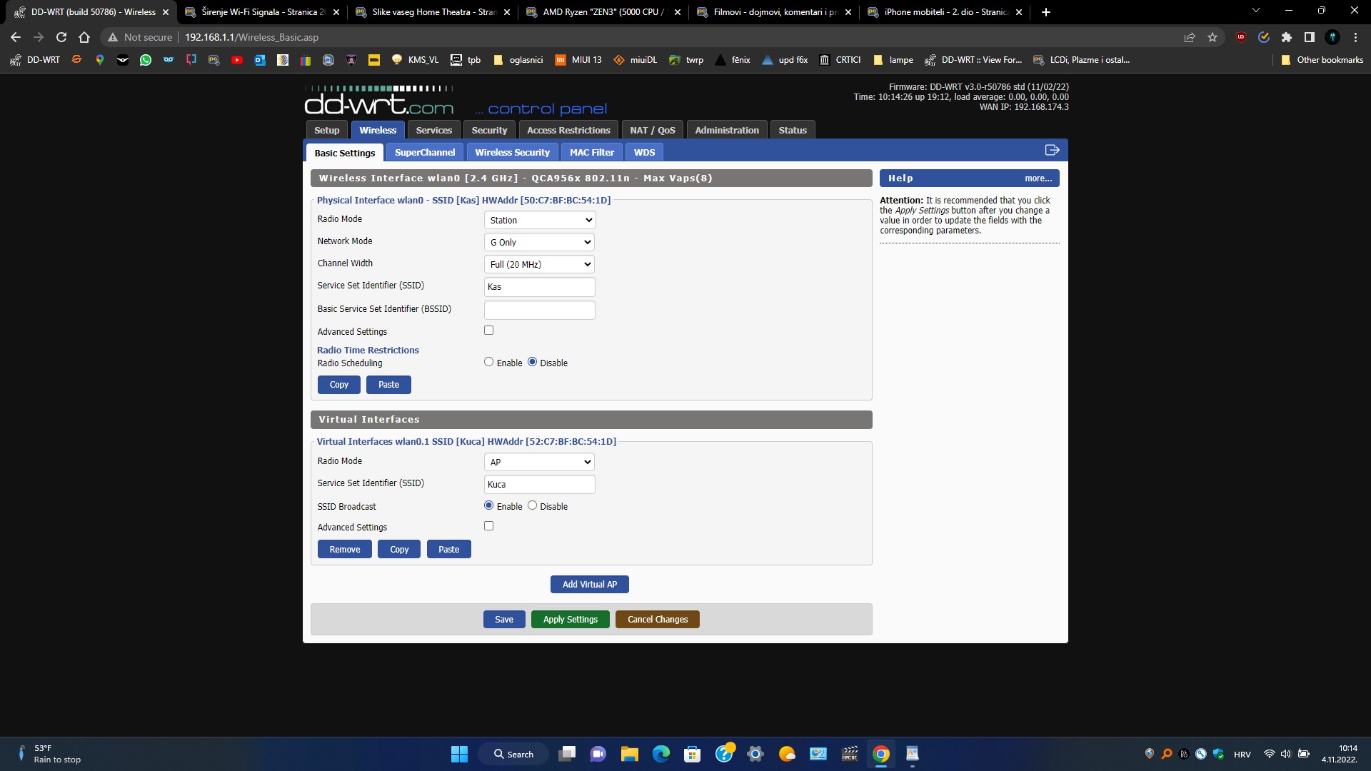

Nov 4 09:37:48 DD-WRT daemon.debug ntpclient[21472]: Connecting to 2.pool.ntp.org [162.159.200.1] ...
Nov 4 09:37:48 DD-WRT daemon.info ntpclient[21472]: Time set from 2.pool.ntp.org [162.159.200.1].
Nov 4 09:37:48 DD-WRT daemon.info process_monitor[17610]: Cyclic NTP Update success (servers 2.pool.ntp.org 212.18.3.19 88.99.174.22)
Nov 4 09:37:48 DD-WRT daemon.info process_monitor[17610]: Local timer delta is 0
Nov 4 09:44:28 DD-WRT daemon.info httpd[1221]: [httpd] : Authentication fail
Nov 4 10:09:55 DD-WRT kern.info kernel: [68889.010000] br0: port 3(wlan0.1) entered disabled state
Nov 4 10:09:59 DD-WRT kern.info kernel: [68892.230000] wlan0: authenticate with 06:0d:64:7f:e9:3e
Nov 4 10:09:59 DD-WRT kern.info kernel: [68892.250000] wlan0: send auth to 06:0d:64:7f:e9:3e (try 1/3)
Nov 4 10:09:59 DD-WRT kern.info kernel: [68892.370000] wlan0: send auth to 06:0d:64:7f:e9:3e (try 2/3)
Nov 4 10:09:59 DD-WRT kern.info kernel: [68892.480000] wlan0: send auth to 06:0d:64:7f:e9:3e (try 3/3)
Nov 4 10:09:59 DD-WRT kern.info kernel: [68892.590000] wlan0: authentication with 06:0d:64:7f:e9:3e timed out

Moze mala pomoć s konfiguriranjem wr1043n v5 (dd wrt) u nacin rada kao repeater.
WR je spojen wifi na mobitel koji hotspota te WR shera dalje na virtual interface wifi s razlicitim SSID.
Desava se da se laptop (w11 build 22621.755/ Intel(R) Dual Band Wireless-AC 8265) povremeno odspaja s repeatera.
Event log kaze error:
Event ID: 5010
Source: Netwtw06
Intel(R) Dual Band Wireless-AC 8265 : The network adapter has returned an invalid value to the driver.
Eh sad, probao sam staviti zadnje drivere s HP stranice za laptop (HP EliteBook 840 G4) a to su: 22.150.0.3 Rev.A Jul 28, 2022 te kaze: Fix and enhancements: - Provides support Windows 11 v22H2. - Provides the security update.
Probao sam i zadnje drivere s intel stranice ali koliko vidim to su driveri iste verzije posto ovo pise na HP stranici a to je ista verzija kao na intel stranici: Driver version in device manager: - v22.170.0.3 for AX411/AX211/AX210/AX201/AX200/9461/9462/9560/9260 - v20.70.32.1 for 8265/8260 - v19.51.42.2 for 3165/7265/3168
Probao sam u device manageru iskljuciti turn off device to save power, wireless mode prebaciti na 2.4 g only. Medutim i dalje se desava random odspajanje.
Slika configa u attachu
Log s ddwrt-a, u 10:11 je event log u windowsu zabiljezio error a ovo je dio loga u to vrijeme:

Dali se isto odspaja ako je zakačen na Hotspot moba (jasno da treba biti u njegovoj blizini) ?
Na slici vidim da si stavio WiFi Network mode na G only, za test probaj staviti b/g/n.
Ako se dešava nekakav biser trebao bi se link spustiti na b standard, to je sporije ali bi veza / link trebao ostati.

Ne dešava se odspajanje ako je direkt na mobu.
B standard sam stavio bas radi testa (učestalije se odspajao u mixed modu) jer mi ionako ne treba zasad nikakva posebna brzina dok ne podesim da barem radi.
Usto dok se laptop odpoji, tablet ostane spojen i normalno ima pristup internetu.
Neznam na sto bi se trebao fokusirati uopce, dal na podesavanje ddwrta ili na podesavanje wifi kartice u laptopu?
BTW, stavio sam u ddwrt radio mode Station i spojio WR na hotspot te kreirao virtual interface i to ej sve, neznam dal moram jos sta podesavati???
EDIT: oš da ti advanced postavke slikam?

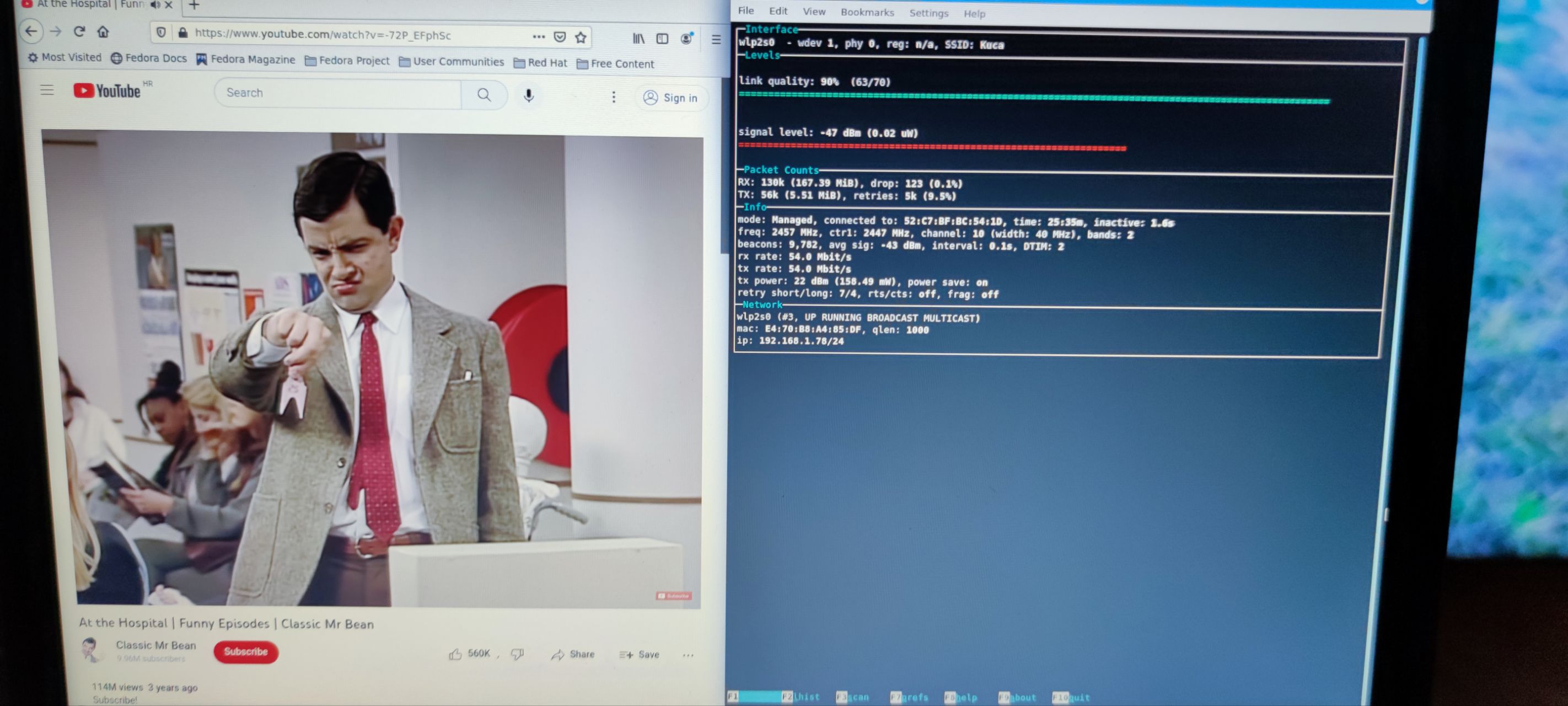

Dobro si se sjetio Live Linuxa jer je to skroz drugačiji os pa se može usporediti u odnosu na winse.
Ovisi koji / kakvi Live Linux digneš pa možda ima detaljniji prikaz,
ako ne na brzinu instaliraš Wavemon, info > https://sourcedigit.com/25336-check-...-linux-ubuntu/
Gledaš Signal level i Link quallity,
ako drastično / prebrzo pada kako se odmičeš od moba / lapa onda nešto ne štima.

Pleše signal level dok je sve na miru od -47dbm / -35dbm, link quality ide 100%-87%. Ruter i laptop sjede na mjestu kao i mobitel, opticka vidljivost na punih 5 metara udaljenosti.
Evo slika preko moba
Sent from my M2007J3SC using Tapatalk

I ne puca link ?
Brojke izgledaju dobro.
E sad šta winsi izvode đava zna
Kao da bi prvi put bilo da forsirani zadnji drajver nešto sj *** e
