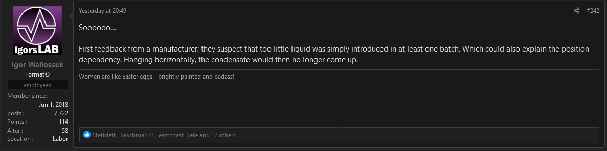

Ko bi ga znal, na kraju bude ispalo da je do tvornice koja zapravo proizvodi te hladnjake ...
Obzirom da su sve to bili referentni modeli za recenzije, stvarno je moguće da su pogođeni određeni retail modeli ili je proizvođač tih hladnjaka sfušal određenu seriju i otišlo je u prodaju.
Igor Wallossek has provided a brief update to Der8auer findings. The possible issue being described is insufficient coolant added to the vapor chamber.
Igor does not want to spoil the der8auer’s new findings, so what is important is that the YouTuber is to share a new video tomorrow which should provide us more information.
Izvor: Igor’sLAB
EDIT:
Although the graphics card examined was an MBA design ("Made by AMD") affected by the temperature problems, Roman Hartung could not identify any obvious symptoms such as defects or design errors.
Eto, u prošlom videu je zaključak da AMD obavezno mora napraviti recall, jer je zahvaćeno sve pod Suncem, dok mu se u ovome sve čini OK.
Hotspot problem of AMD’s Radeon RX 7900 XTX (MBA): Even several batches of the vapor chamber affected, replacement of thousands of cards starts
However, I explicitly point out that all this information should be considered preliminary until an official statement from AMD and that there could still be corrections to the mentioned numbers. Of course, one can ask why all this was not recognized much earlier and why quality control obviously failed so grandiosely. This also has something to do with the fragmentation of production and supply chains. Both the chamber and the complete cooler come from a third-party manufacturer far in advance and are of course very difficult to test without the board assembled. If the PVT samples (Production Validation Test) worked, then later one takes samples from the current MP (Mass Production) at most. In the best case, such cards are tested e.g. at PC-Partner in special hot boxes, but are there in a vertical setup. And then it comes exactly to the occurred case, because the affected vapor chambers are not completely non-functional, but only more or less limited functional. However, this is almost impossible to monitor with granular tests.
Izvor: Igor'sLAB
Zadnje izmijenjeno od: The Exiled. 04.01.2023. u 10:17.

Vapor gate including failure of the entire quality management? Background on the cooler problem of the AMD Radeon RX 7900 XTX (MBA)
To be fair, I have to state that some of my conclusions are based on information from third parties (involved parties), but it seems completely plausible when looking at the usual business processes. I am, however, familiar with the processes at the manufacturers involved, because there are no real secrets there either. But what went wrong in detail must now be worked out and clarified by quality management as quickly and completely as possible. The globality and complexity of a quality management system includes all customer-supplier relationships and acts as a permanent, intensive interrelationship between them. And when we speak of quality here, the quality concept used stands as a unity of condition and quality requirement. The quality demanded is therefore not the maximum feasibility, but the correct realization of the quality requirements defined for a cooler. Errors can always happen and there is no such thing as 100% error-free production. But one must always strive to approach this unattainable ideal with a so-called zero-failure strategy.
What does it actually take to make a graphics card or do the finishing work? First of all, you commission board manufacturers to deliver the bare PCBs to the manufacturer, you buy all the components and sometimes even have the belts for the SMD components already assembled by third parties – and you buy a complete cooler. Before I go into this cooler and the other entanglements in the delivery process, let’s take a rough look at this with quality management first so we can also grasp the fundamental problem. While quality management is in the hands of AMD and, to a large extent, the contract manufacturer, third-party providers and suppliers must fit in seamlessly here. This is definitely a rocky road in the case of the RX 7900 XTX, as the cooler is supplied by Cooler Master. However, Cooler Master is also only “man-in-the-middle”, because the cooling construction including the vapor chamber is again made by Asia Vital Components Co, Ltd. (also known as AVC for short). So while QM is up to AMD and the contract manufacturer, Cooler Master has to subordinate and ensure QA on their part. The actual manufacturer AVC must in turn subordinate itself to the superordinate QA (and thus also to the general QM) and ensure QC on site during production.
