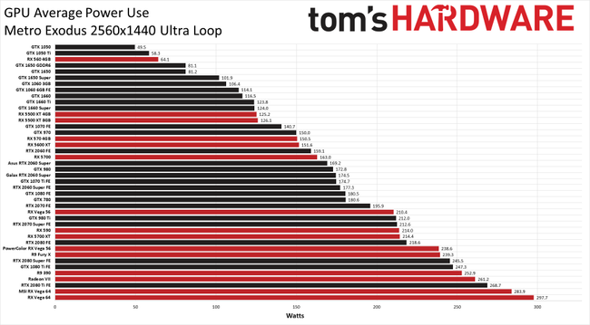

Techpowerup testirao potrošnju i efikasnost GPU- ova
https://www.tomshardware.com/feature...umption-tested

GPU Efficiency - Relative Performance Per Watt
GTX 1660 Ti	100.0%
RX 5700	96.8%
GTX 1660 Super	96.7%
GTX 1650 GDDR6	96.3%
RX 5600 XT	93.8%
RTX 2060 Super FE	93.8%
RTX 2080 FE	92.1%
GTX 1650 Super	91.7%
RTX 2060 FE	90.1%
GTX 1050 Ti	89.5%
RTX 2070 Super FE	88.7%
GTX 1660	88.2%
RTX 2070 FE	88.1%
RTX 2080 Ti FE	88.0%
GTX 1070 FE	85.9%
GTX 1650	85.7%
RTX 2080 Super FE	84.9%
RX 5700 XT	83.7%
GTX 1080 FE	82.9%
GTX 1060 6GB FE	76.9%
GTX 1070 Ti FE	76.8%
RX 5500 XT 8GB	76.6%
GTX 1050	75.5%
GTX 1080 Ti FE	74.5%
GTX 1060 3GB	74.3%
RX 5500 XT 4GB	69.2%
Radeon VII	68.5%
RX Vega 56	65.2%
RX 560 4GB	64.1%
GTX 980	52.2%
GTX 980 Ti	51.3%
GTX 970	51.1%
RX Vega 64	49.2%
RX 590	47.4%
RX 570 4GB	45.3%
R9 Fury X	39.1%
R9 390	31.8%
