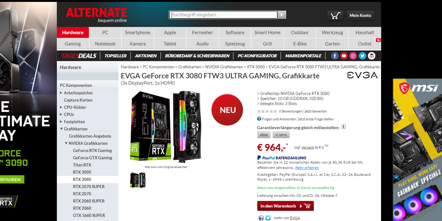

Ma kako da ne:
ID:	22773   Click image for larger version
