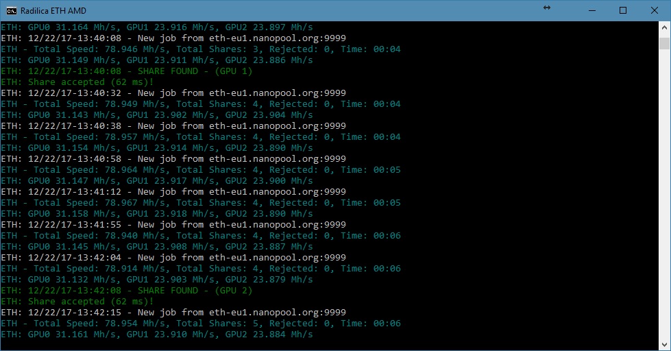

Trenutno stanje.
ID:	18924   Click image for larger version
