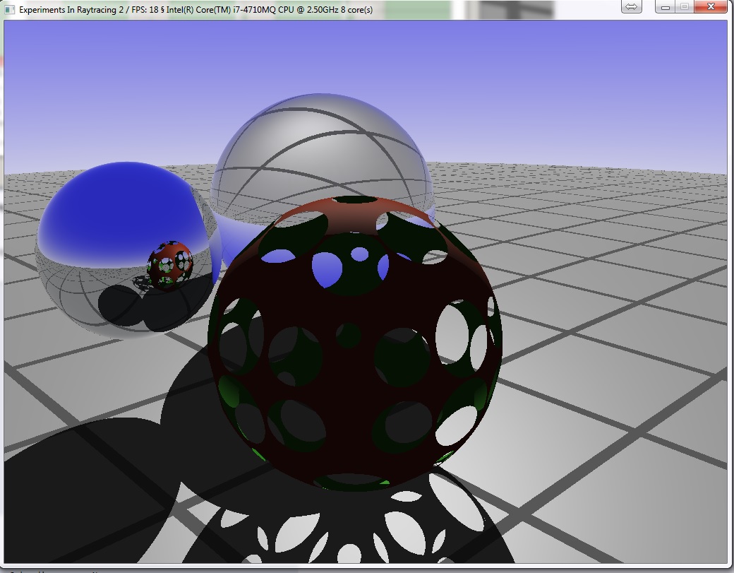

Staro 06.04.2016., 20:57   #1588
darkydark
N0teb00k n00b
darkydark's Avatar
Lokacija: Zagreb/Koprivnica
Postovi: 2,109
Intel Core i7 4710MQ - 18FPS
