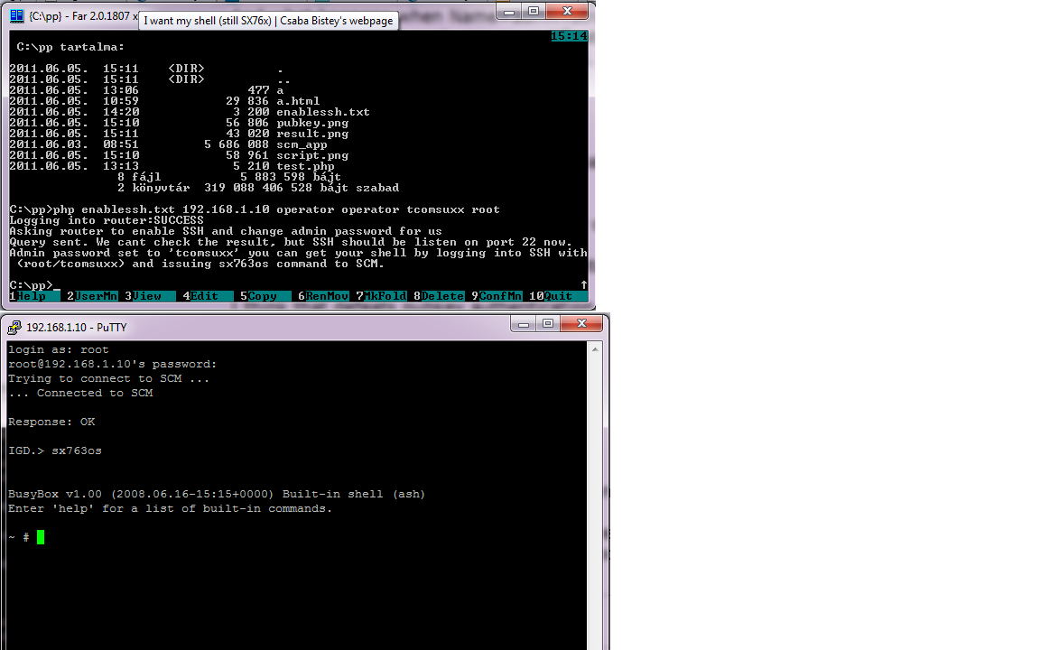

Well, locked my router as forgot to delete 1copy1 from pubkey
Luckily there is an easy way to get in netherless. We all know there are two administrator user on SX763 root and administrator, the unlucky ones have that pubkey to get administrator locked out, root is not locked out. So first was trying to make the script do the access control tamper way, first it is quiet unpredictable (times command was run times it did not). Then started to mess a bit more with V_PasswordService and not just password writeable by anyone but its name key too.
And what happens when Name=administrator becomes name=root?
Scm_app overwrites root user as certificate limitation only on administrator, shell can be opened for root, though scm_app replaces its shell to mgmt, but we can escape from that with sx763os command, and can delete that nasty 1copy1 key from config.
New script attached to the post.
Its usage would be:
php enablessh.txt routerip webuser webpassword newadminpassword newadminname
Example:
php enablessh.txt 192.168.1.10 operator operator tcomsuxx root
That logs in to web interface using operator/operator, enables ssh, changes admin password to tcomsuxx and changes admin username to root
I think that defeats pubkey authentication completly (unless it is set up on root too what i doubt), it worked for me not sure if it is works on "locked" devices but not see anything why it should not, and it unlocks webinterface admin too as admin_role becomes root as we know root password (changed it to tcomsuxx this case) that password should be accepted on webinterface too (as admin_role is default )
There is one side effect due administrator name change, "administrator" user password stays default (what is logical as scm_app changes root user instead)

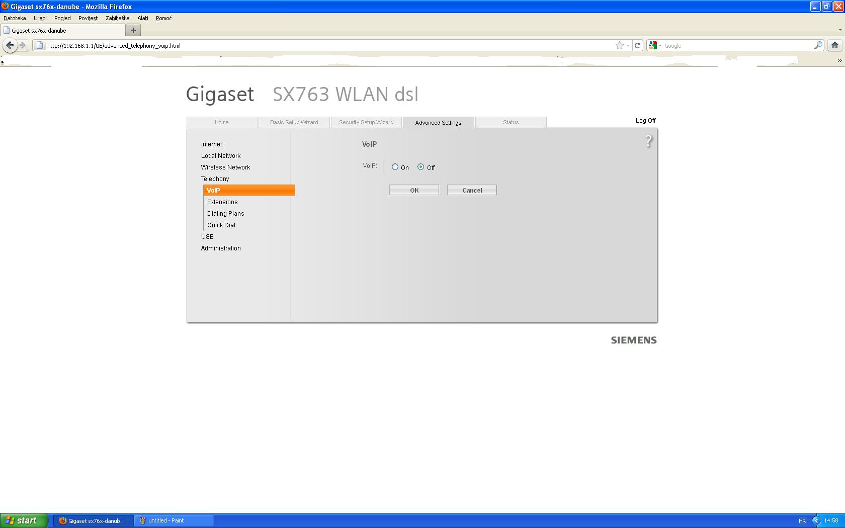

Staro 06.06.2011., 15:12   #672
zagi
Lokacija: zagorje moje malo
Postovi: 112
Nadam se da postam na dobar topic, ako ne, nemojte me mrziti.

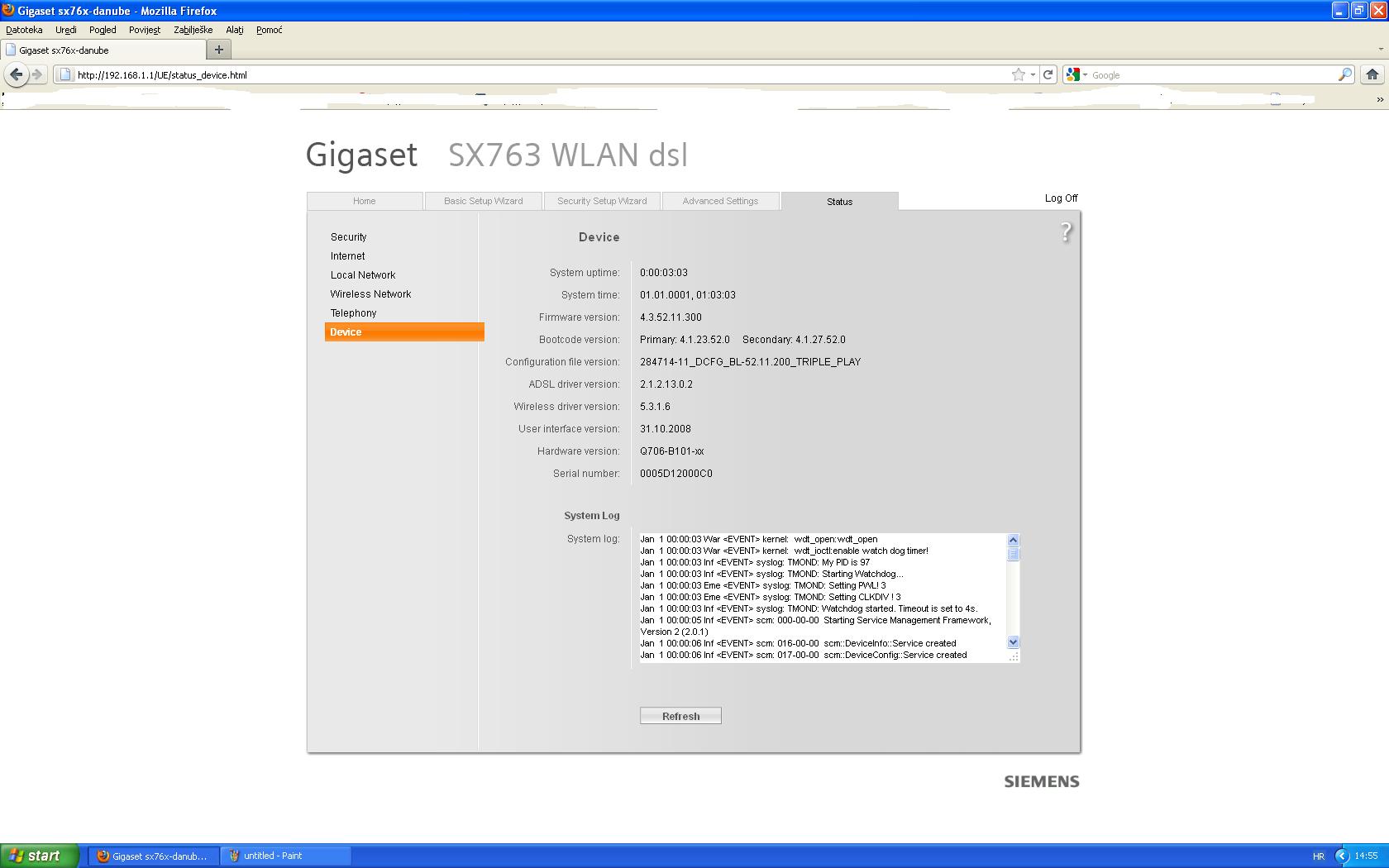

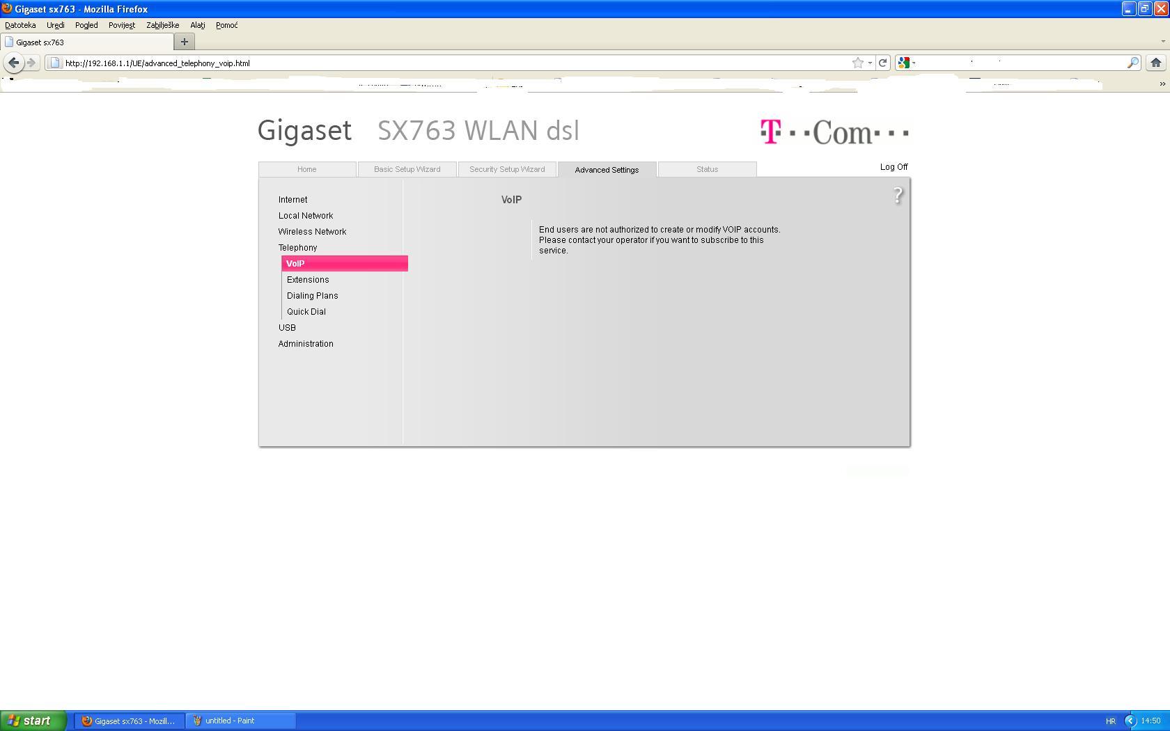

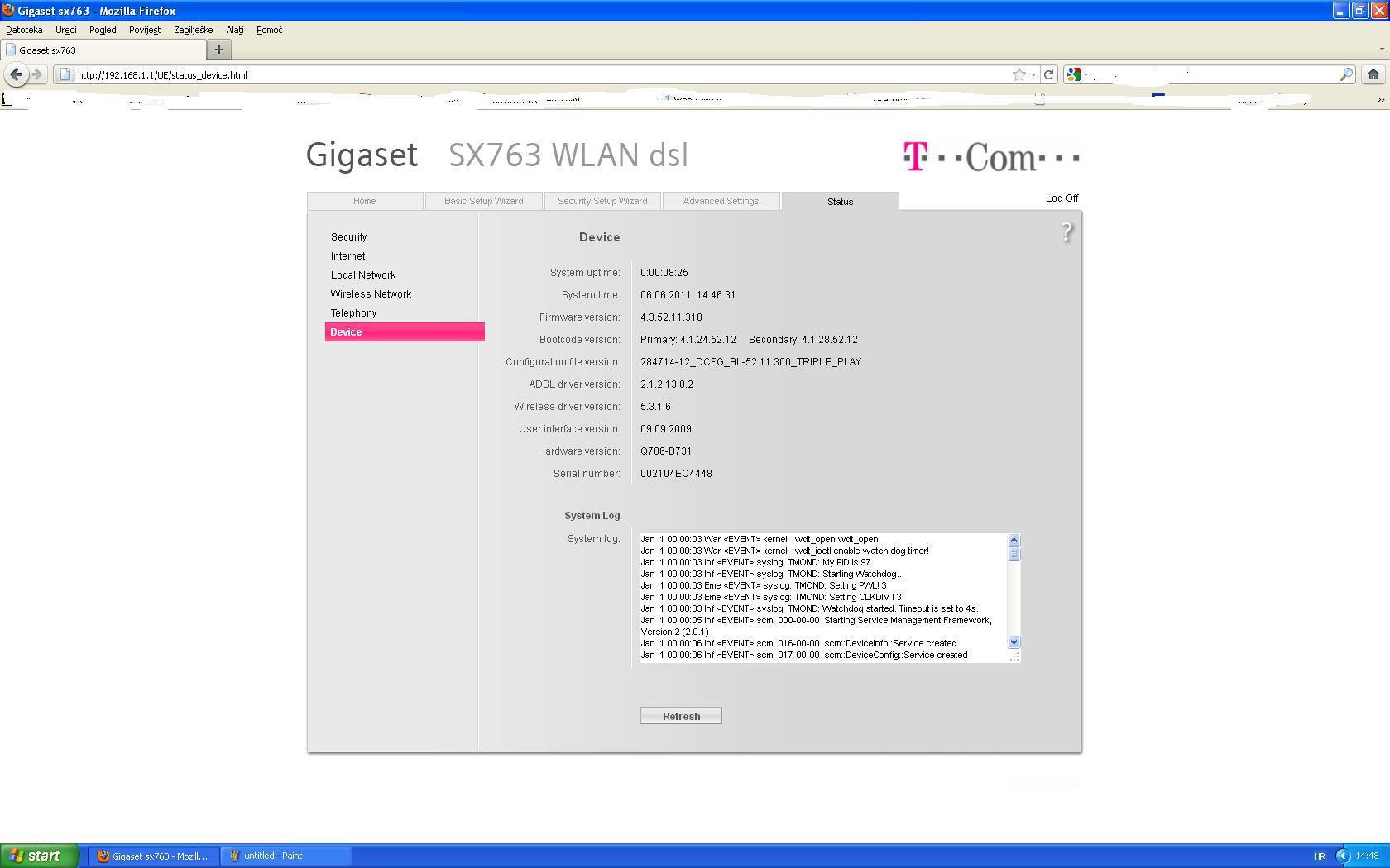

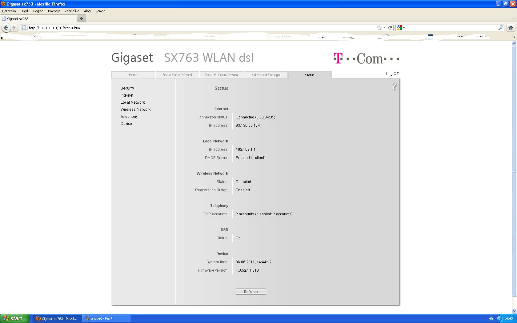

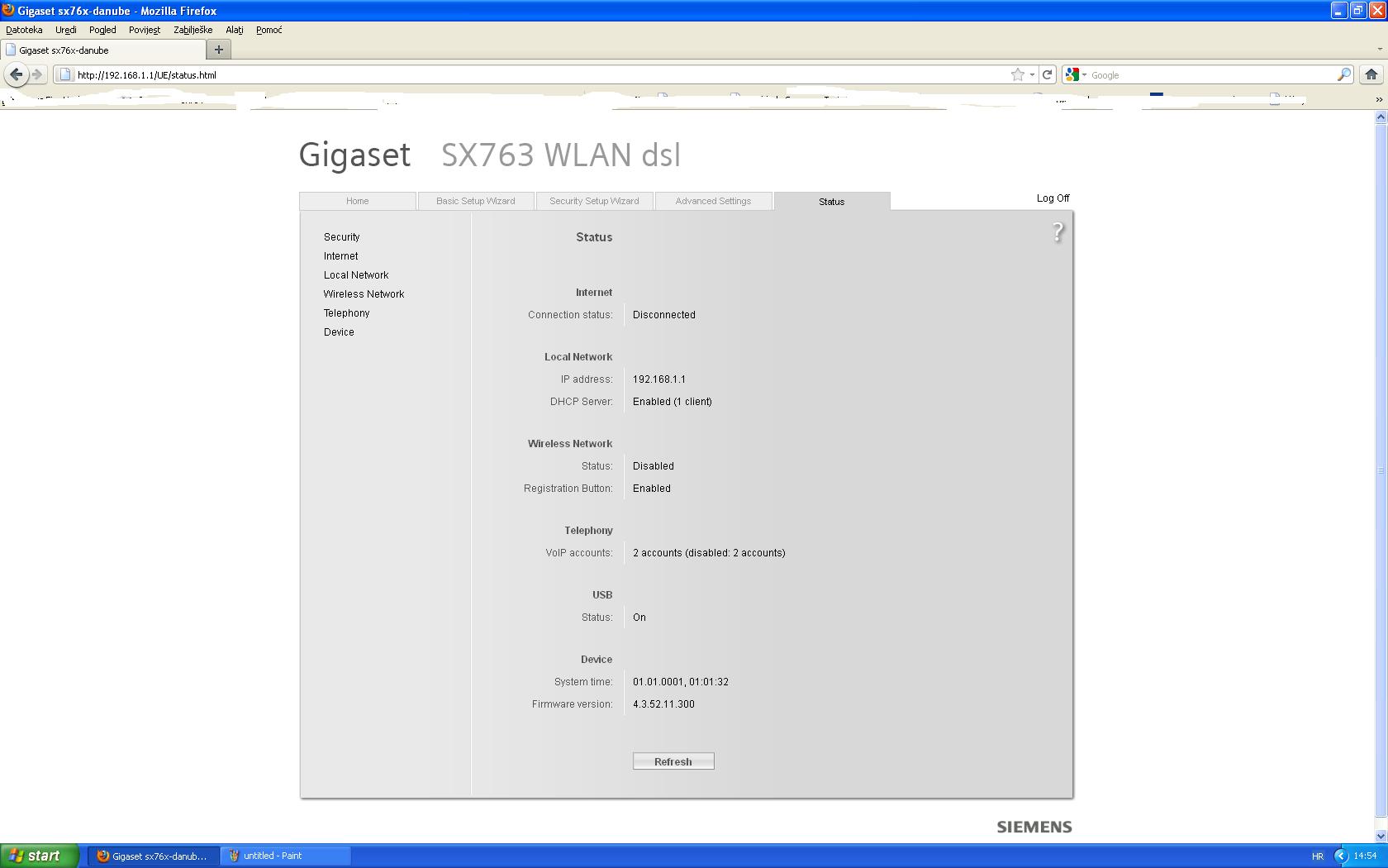

Uglavnom jućer od groma crko moj sx 763- T-com. Prijavio kvar i danas dobio drugog. Ono što je zanimljivo izgleda da je greška kod t-coma i da je stari ruter povukao neki neispravan firmware (ako je to moguce ? ). Veze na net nemam na starom primjerku (online ne svijetli), ali u njegovom izborniku nema više T.com ovog loga, , otvorila mi se mogućnost za update firmwarea što kod novog nema. Sad, ubacio sam nekoliko prnt scrinova pa vidite što se dogodilo, i jel bi se dao stari router ikako osposobiti da radi ??

Staro 06.06.2011., 17:15   #673
.Delboy
.Delboy's Avatar
Datum registracije: May 2008
Lokacija: hr
Postovi: 755
Nije povukao krivi fw, nego je nvram particija dobila nekakav error (zna se nekad desit) pa se resetirala na onu defaultnu, ali i dalje bi trebao ruter raditi kao prije.
Mozda je problem u configu, probaj stavit taj iz novog.

Ruter ne radi nikako, tj online lampica ne svijetli i ne može se uspostaviti veza, a za config, hm, sigurno ima negsje, ali ne mogu naci postupak kako da iskopiram iz ispravnog, pa ako moze mala pomoc.

E da, puno hvala na brzom odgovoru, to je nas dobri hackerivs zaboravio (eto sto se desava kad pises poruke u sitne nocne sate) na ovaj set ispred komande, dakle
set V_PasswordService.Administrator.Name = root
I kad se sve napravi onda prvi korak izgleda ovako:
i drugi korak ovako:
