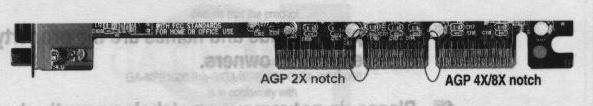

Upravo to, prvo sto pise u uputstvima za MB je:
When you installing AGP card, please make sure the following notice is fully understood and practiced. If your AGP card has "AGP 4X/8X (1.5V) notch (show below), please make sure your AGP card is AGP 4X/8X (1.5V).
Slijedi slikica rubnog konekktora na grafulji, sa svim utorima i ispupcenjima, kakav je i na mojoj staroj MX100/200.
Zatim nastavlja:
Caution AGP 2X card is not supported by Intel(r) 845(GE/PE) / 845(E/G) / 850(E) / E7205 / 865 (G/PE/P) / 875P. You might experience system unable to boot normally. Please insert an AGP 4X/8X card.
To je popraceno znakom upozorenja (usklicnik u trokutu, kao gore!)

Što hoće reći da kartica neće raditi u AGP 2x sa nabrojanim Intelovim čipsetima.
AGP rev 1.0 = 1x 2x
AGP rev 2.0 = 1x 2x 4x (nisam siguran za 1x)
AGP rev 3.0 = 2x 4x 8x
