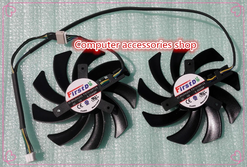

ovako izgledaju zamjenski
http://www.ebay.com/itm/85mm-Sapphir...4AAOSwx-9WuGqZ
https://www.aliexpress.com/store/pro...219043149.html
